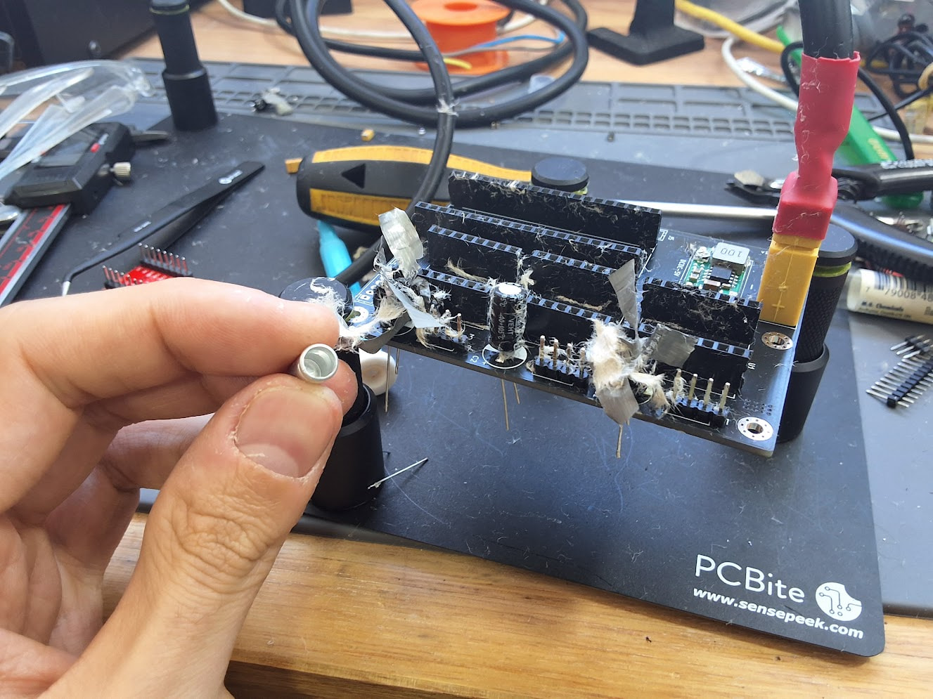

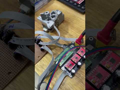

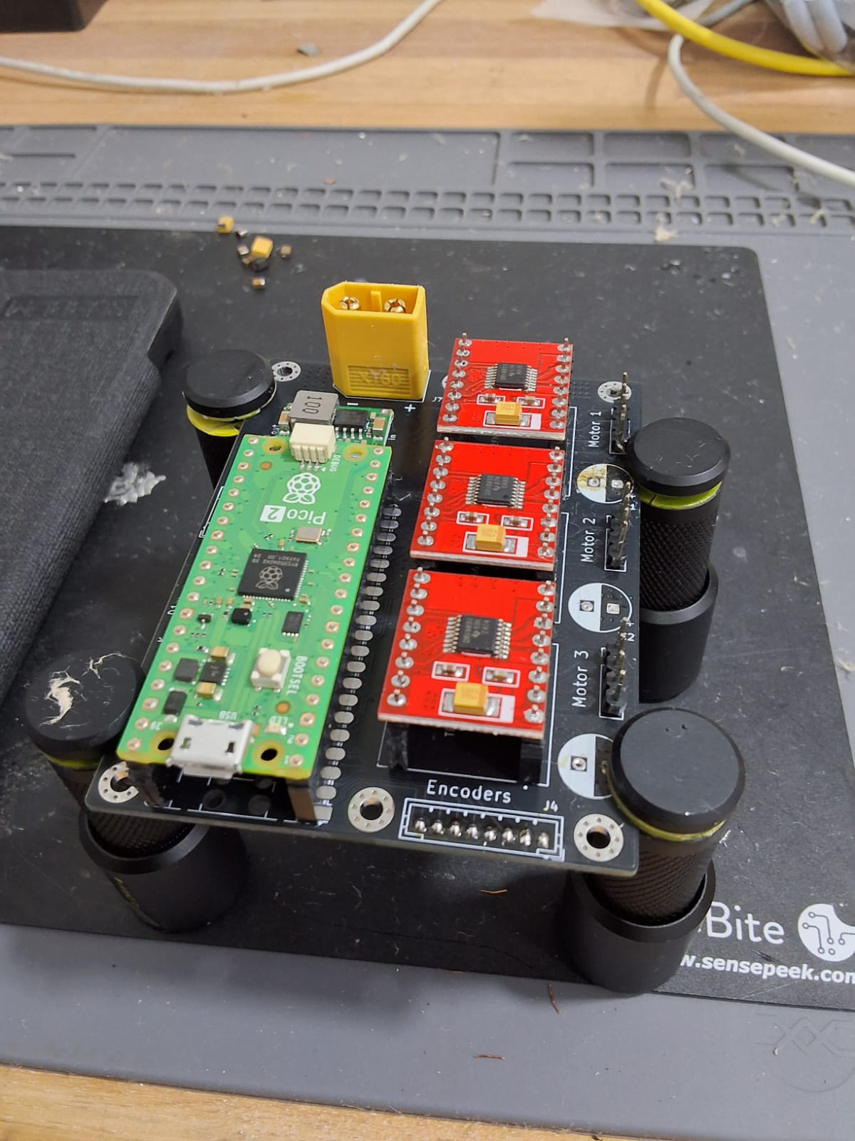

This is the end of April, and here is the update as promised :slight_smile:
Video:
Assembled PCB:

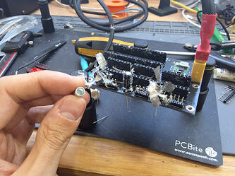

The process went well with minor injuries. Several capacitors, presumably from a bad batch, exploded on us while populating the driver PCB, adding adrenaline to the experience.
Some parts are rather difficult to source. If someone wants to join the fun, let us know.
The team is, so far, @biomakers_lab, @FranQuero, @NoelGaspar7, my cousin, and yours truly.
