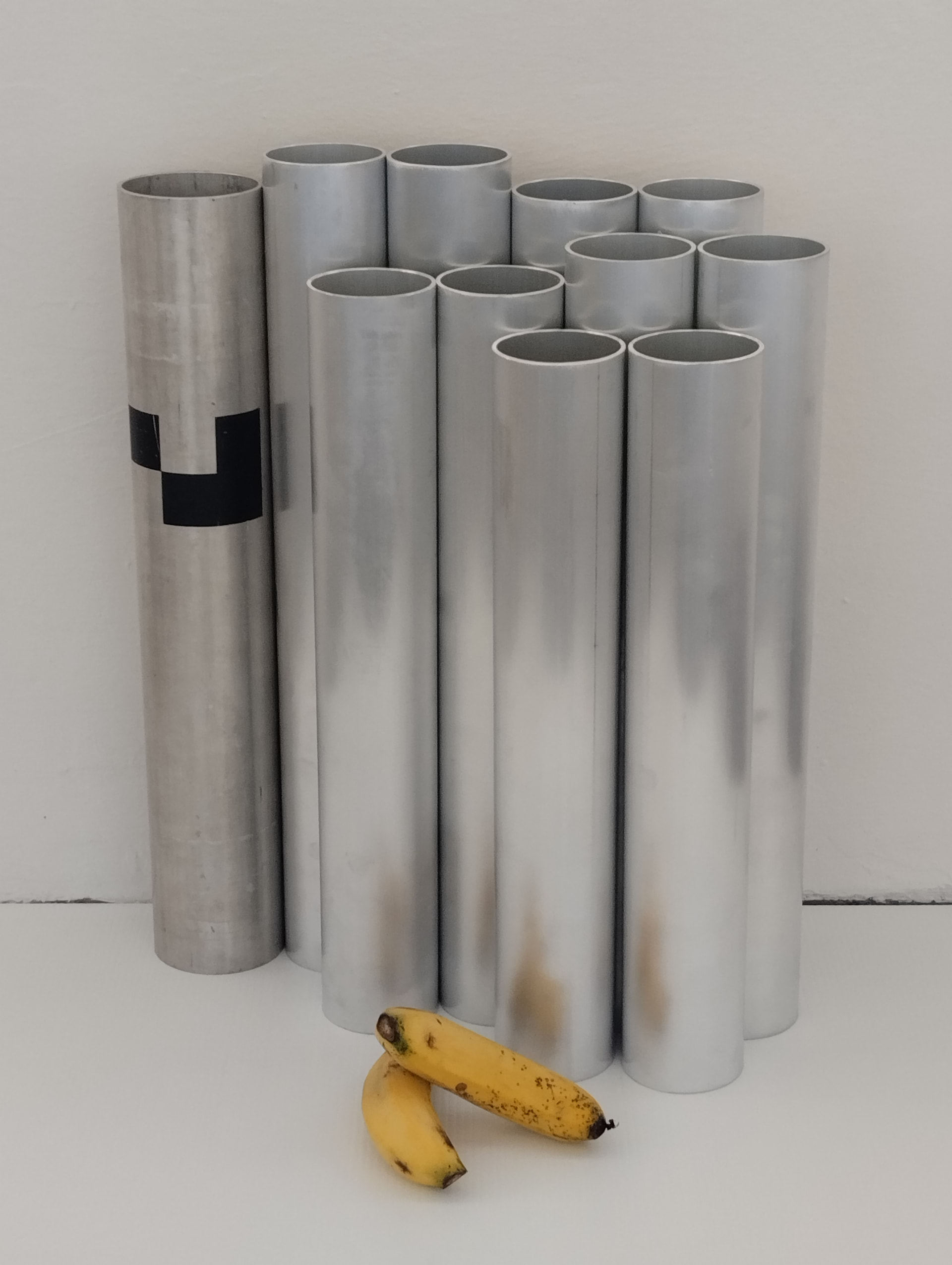

I got 10 aluminium hull tubes cut, from 460mm to 540mm long. They are all OD 3" compared with the original prototype which is 3-1/2". I won’t use them all, but will choose the appropriate length so that minimal trim weight will be necessary. Each hull tube will later have 4 holes drilled in each end to secure the bulkheads. Otherwise, they are as-delivered from the hardware store. I had the tubes cut now so that I can measure them before committing to the design of the bulkheads. As it turns out, the tubes did come with thinner walls (by 0.1mm) than declared!

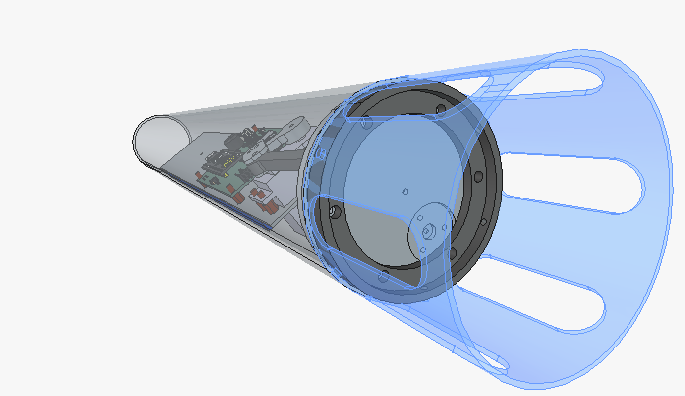

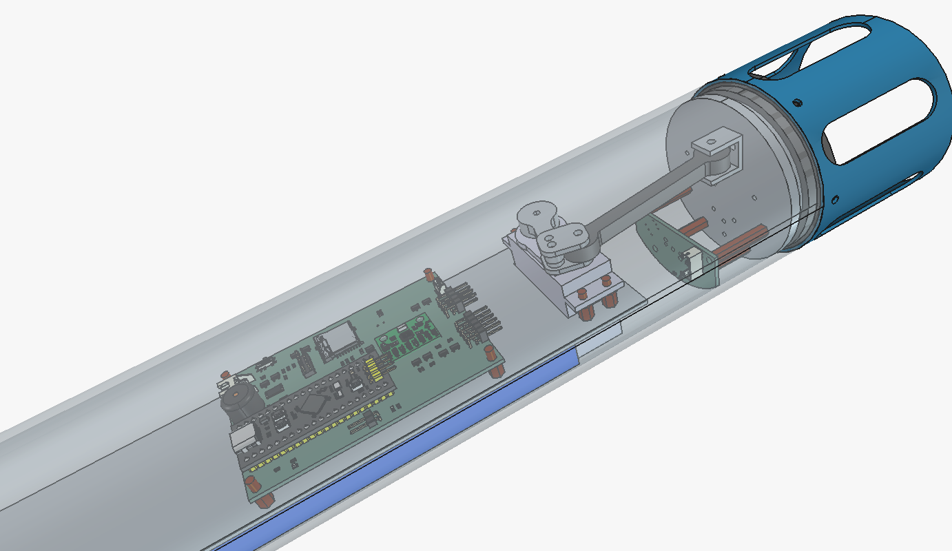

The 3D model is coming along! The front portion of Simple Sub is not yet modelled, but the first image shows the rear portion. The lipo battery is the long blue slab under the main PCB (the first spin of which is about ready for the board house). You can see the servo (mounted in a hole in the sole plate) that acts to move the inner assembly to pitch nose up or down. The thruster motor will be mounted on the small PCB whose standoffs mount to the bulkhead such that the propeller shaft goes through the bulkhead. You can see the detail for the waterproof gland for the shaft, in the second image, which also displays the real estate available on the bulkhead for sensors, which will include at a minimum, sensors for depth, temperature, and electrical conductivity. The blue cage protects them from damage but permits the free flow of water.

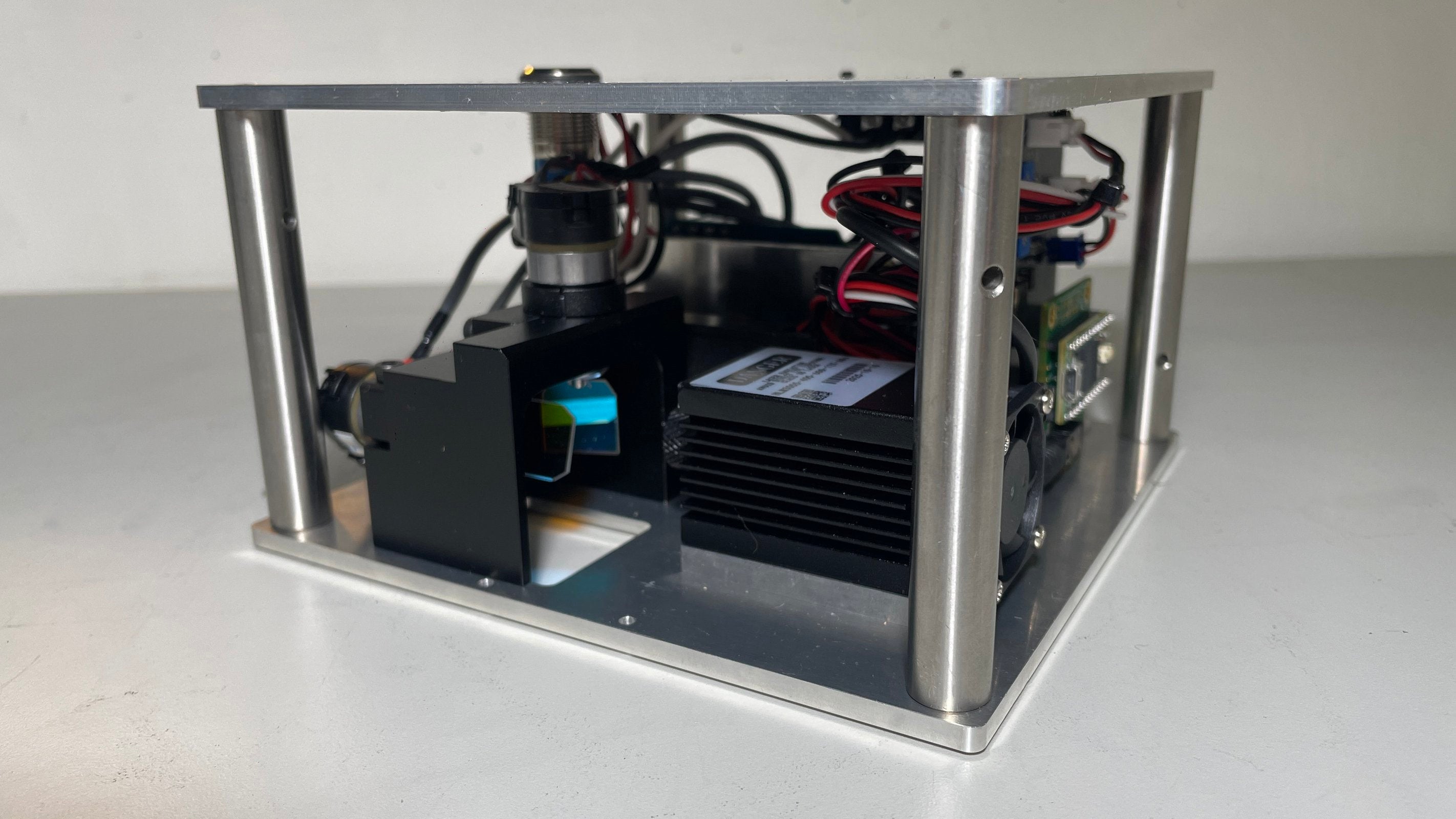

Good to see you here and thanks for the inspiring conversation before! I’m interested to design an alternative cytometer or fluorometer with laser scanner for a SUV project, I still think laser scanning will make an interesting result.
I am selling this teensy based programmable galvo but it’s also an open source project.
This was the note of low cost “galvo-scanned optical flow analyzer with hybrid CMOS + DIY dye sensitized solar cell (DSSC) photochemical sensing” for a IFCB:
I make my own DSSC, I like them because you can tune the absorbance spectrum by dyeing it with different plants dye and make them at home.
water sample / microfluidic channel
laser sheet or galvo-scanned laser spot
CMOS camera captures morphology
photodiode detects scattering / fluorescence timing
multi-DSSC cells detect wavelength-dependent photocurrent response
