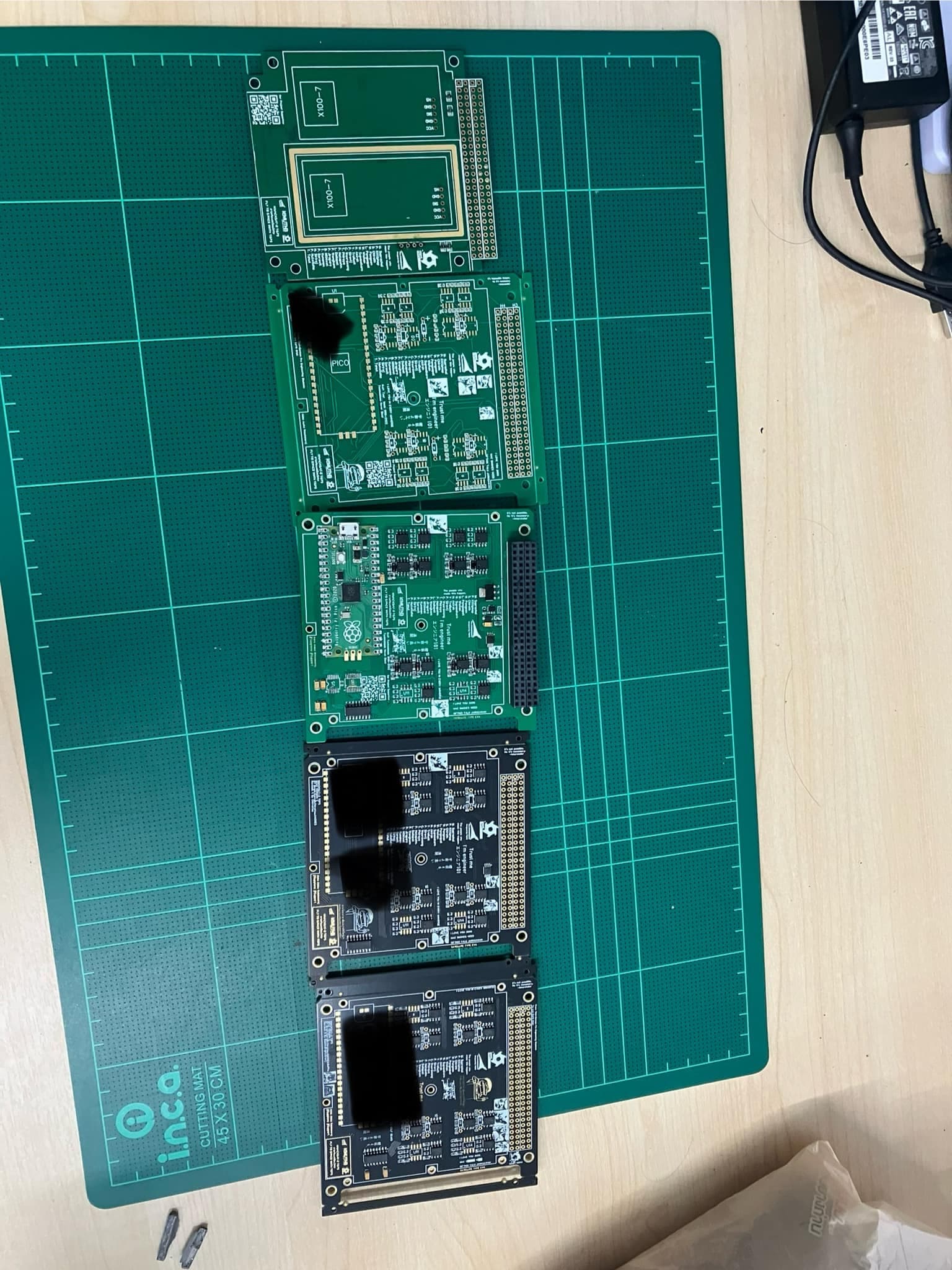

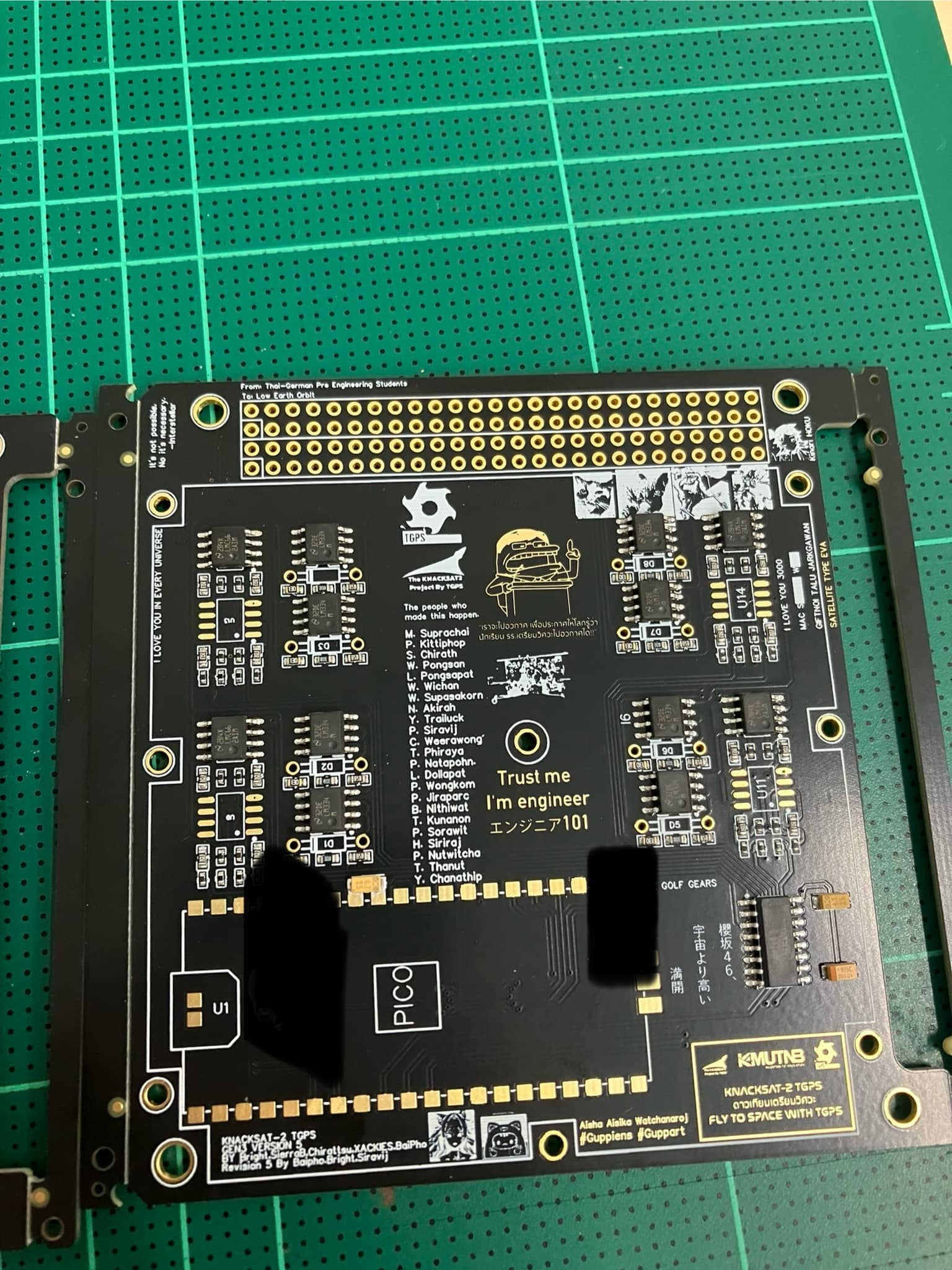

Hi everyone, I’m Siravij,you can call me BB! I just know GOSH from FOSSASIA2025. I would like to share my project during 2022 - 2024, It’s one of the KNACKSAT-2 payloads that I made to be a Payload for the satellite. It’s Call KNACKSAT-2 TGPS You can see all open source PCB and Coding in this GitHub!
So, We making a Home-Made Radiation Shield and compare it with non-Shield, By Using RADFET (MOSFET that specifilialy design for Radiation exposing) using Varadis RM-VT03-A (Welcome to Varadis | Our Product Range) by using constant current to RADFET when it expose to radiation,the current will flow more as it expose to radiation and SD card as well, We use Raspbery Pi Pico for Main communicate with Main Sattlelite bus; currently sattlelite is on hold due to regulation with NBTC to be release at KIBO Module At ISS
Main repo: https://github.com/KNACKSAT2-TGPS\
PCB: GitHub - KNACKSAT2-TGPS/KNACKSAT2-TGPS-PCB: KNACKSAT2 TGPS PCB Section
Code: GitHub - KNACKSAT2-TGPS/KNACKSAT2-TGPS-Code: KNACKSAT2 TGPS Coding Section
