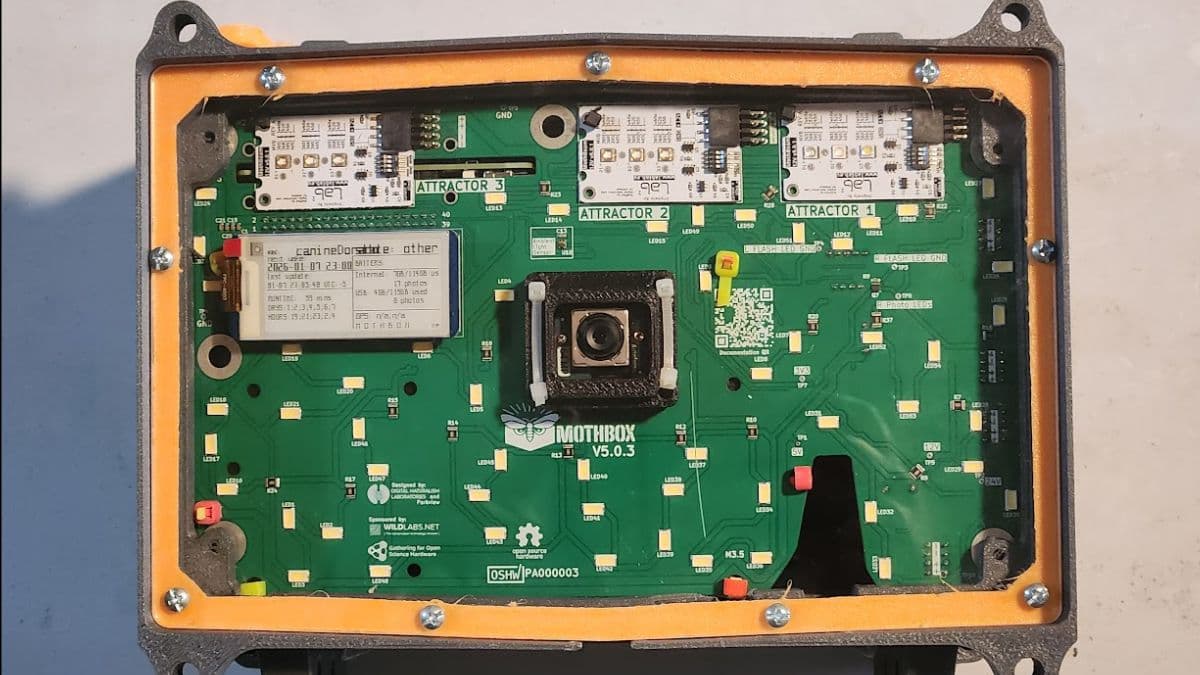

  • Mothbox Pro - This is the latest (version 5) coming soon (shown in picture at top)! It’s made to be SUPER SIMPLE to put together and mass manufacturable. This is the one we are going to have pre-orders available hopefully soon with the Open Science Shop. It consists mainly of an open source, manufactured Printed Circuit Board (PCB), that connects to a raspberry pi and a battery.

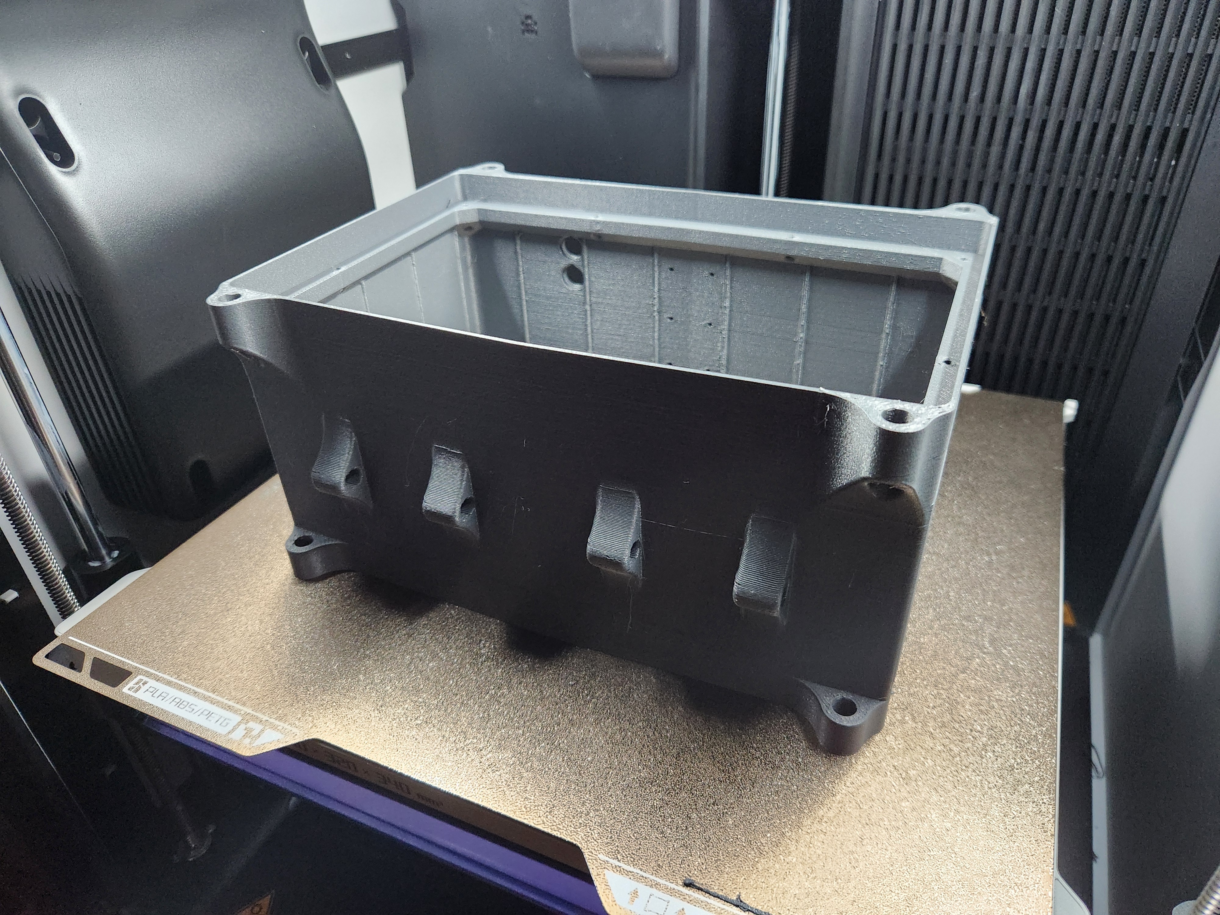

3D Printed Enclosure Refinements
I have been meticulously working on the new carbon fiber PETG housings for the Mothbox Pro. I shaved 400 grams and 4 hours of print time off the current designs! I also tweaked them so they can print WITH NO SUPPORTS! Its widest dimension is also 254mm, so it should be printable on most current 3D printers available! We have tested it during the wettest of the wet season here and it stayed fine inside! There’s also options to print TPU gaskets we designed to make it extra waterproof (or you can eschew these if you are in dryer regions)

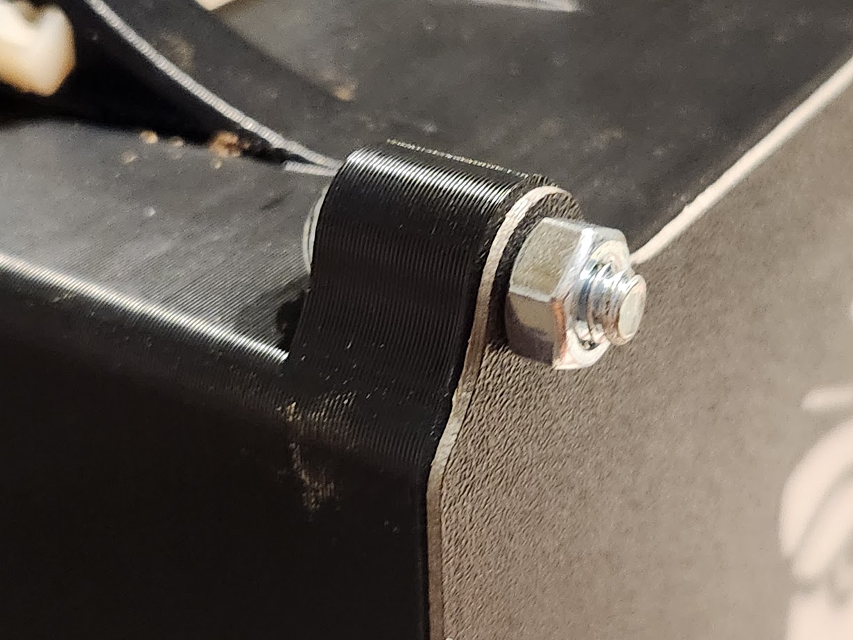

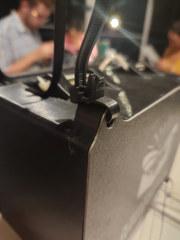

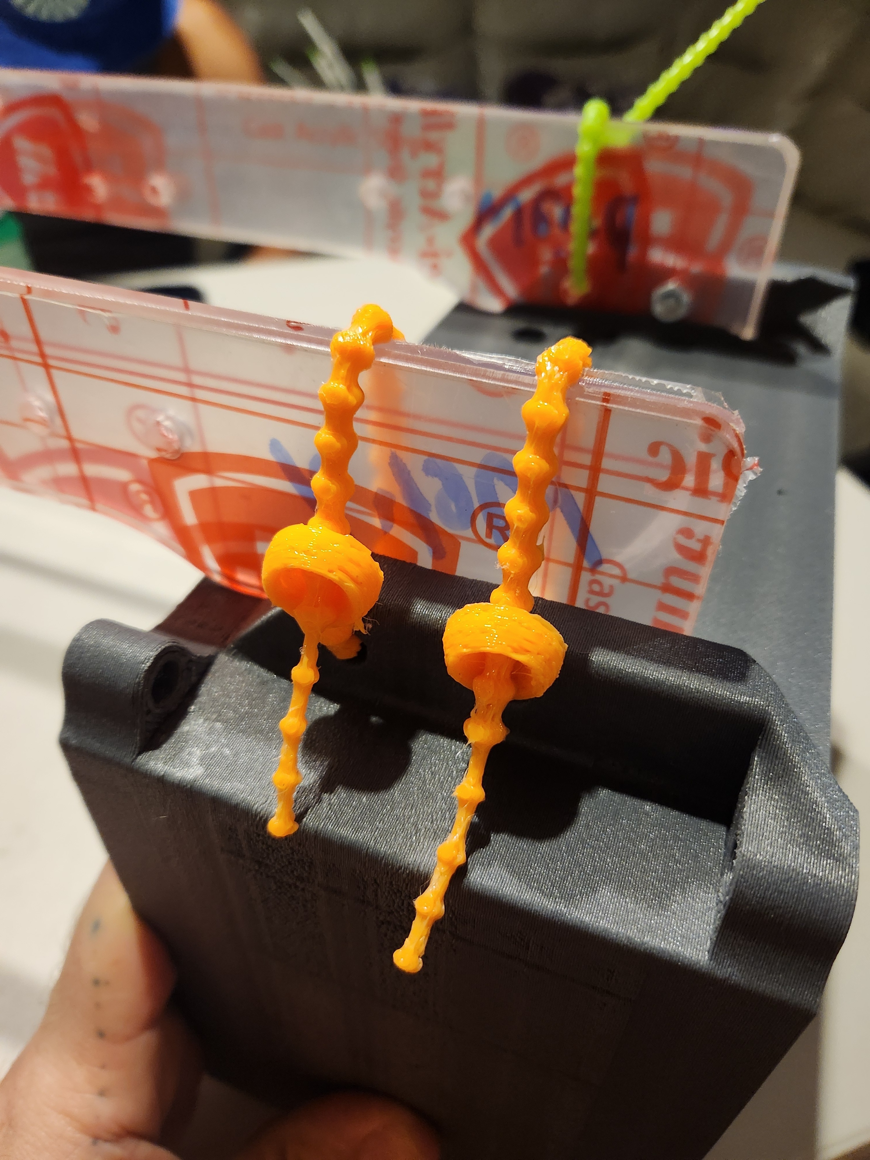

Cheap and Lightweight Closures - No Bolts Needed!
In the previous Mothbox Version, everything was connectable via 1/4 (or M6) bolts. This was because they are pretty ubiquitous and reliable. But they do need two hands to close, are annoying when you drop a nut in the forest, and do add a non-trivial amount of weight and expense.
We did some field testing with Camilo and the Bat team, however, on some alternative ideas though that seem to be quite popular! The designs are still backwards compatible (you can still use bolts), but now you have 3 more options to secure your mothbox in the field!
  • Lightweight re-usuable zip-ties (Cheap! Light! Some versions are a bit finicky)
  • Silicone Zip Ties! (The most popular! Light, cheap! Becoming more ubiquitous! Appear a bit NSFW!)
  • Our own Printable TPU Silicone Zip Ties (While you are printing stuff, you can just print these too!)
If you have deployed mothboxes in the past, I think this is one of the things that you will be excited about!

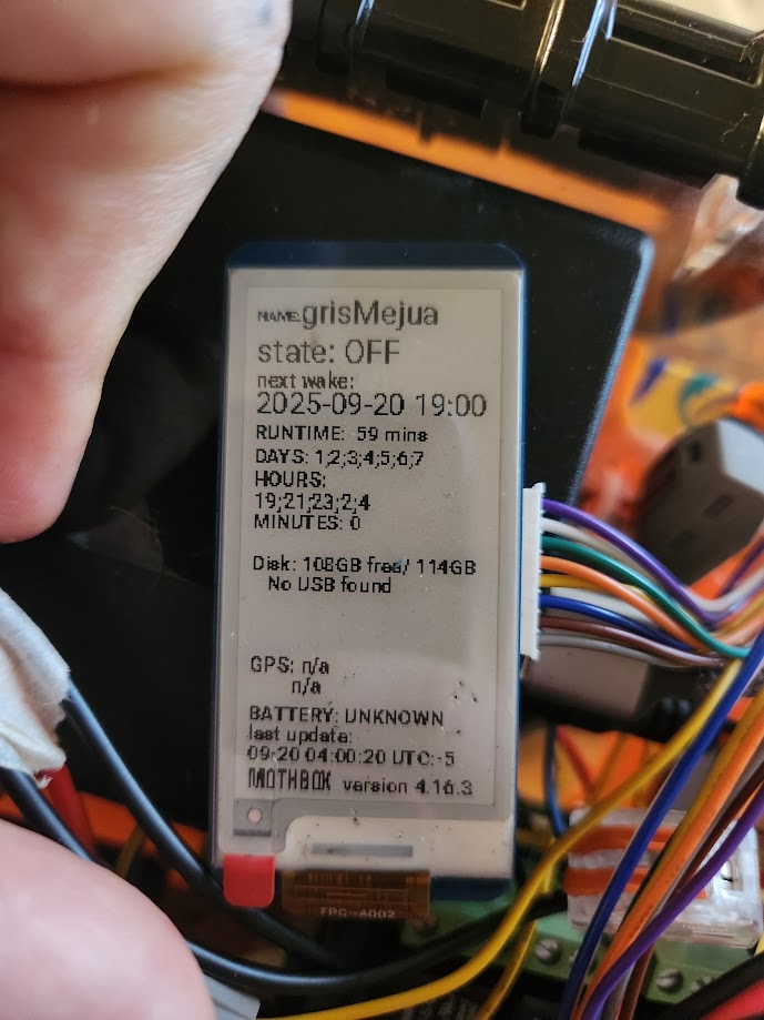

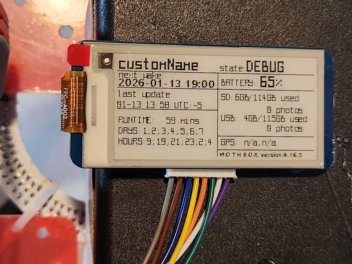

More Feedback
The epaper display shows not only how much storage space you have left in there, but how many photos have been taken! This can be useful if you are checking on them in the field to see, at a glance, that your device ran when it should have!

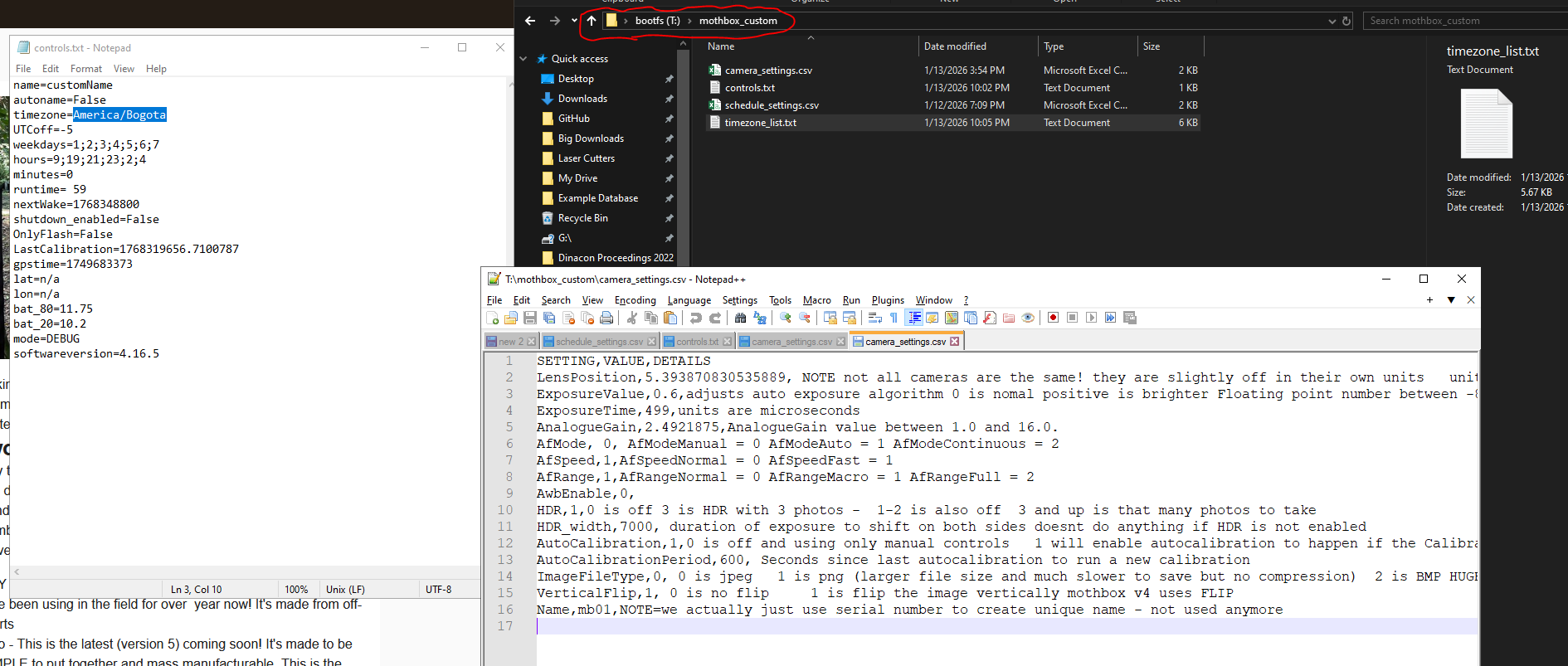

Easy Customization (This is big!)**
Before today, once you built your Mothbox, to get it running correctly (in somewhere that wasn’t Panama), you had to follow the steps on this entire guide we made:[ Configuring Mothbox | Mothbox](http:// Configuring Mothbox | Mothbox) (because of how raspberry pi works).
You would have to get special software, change your wifi to match the mothbox’s, log into it virtually, and change some parameters (most importantly the timezone!).
But no more! We found a way to hack around that!
Now it’s easy!
You just
  1. flash your image onto an SD card
  2. edit some txt files on that same SD card
    And that’s it!
    You can easily customize:
  • Timezone
  • Mothbox name
  • camera settings
  • schedule
  • battery indicator voltages
  • and more!
without having to SSH into your raspberry pi or any fancy stuff like that!
Display Improvements
The Epaper display has been such a handy addition to the mothbox. It really helps people in the field know what their mothbox is up to and helps assure them things are going to plan. That said, the display i made previously for it was a bare working example. I recently got roasted a bit on bluesky for the font choices of it and Kit helped me chunk the data to have a much cleaner, smoother appearance. And the folks on bluesky helped us find “hinted” open source fonts that can still display well on low resolution displays.
The open hinted fonts are “Clear Sans” and Scientifica btw.

The New PCBs are (Hopefully almost ready!)
We had some awesome protoypes built in december that we have been testing out here, and they appeared to work perfectly except one minor, non-critical chip was manufactured backwards. We tweaked that design, made the board a bit thinner and lighter, and ordered what will hopefully be the last protoype before we go into bulk manufacturing! JLC had some internal delays they apologized to me for, but hopefully we will get these prototypes within a week or two (and they will just work!)!
