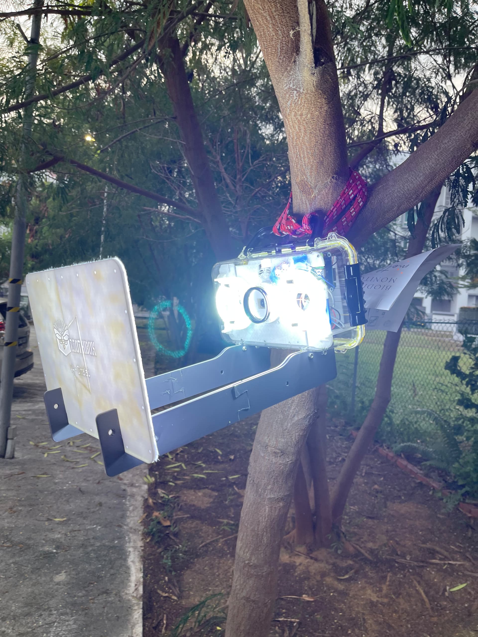

We use internal UV lights now
We share how to make a internal UV light so everything is nice and tidy and protected in the field, along with more elegant designs for connected any external UV light too!

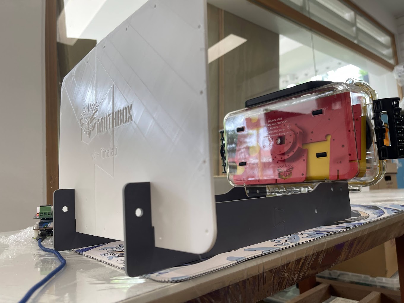

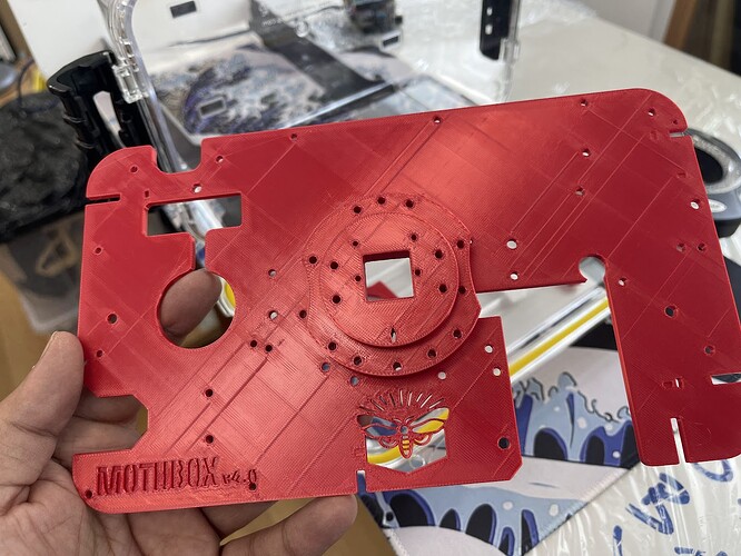

I’m replicating this for a proof of concept here in SG, will post updates as I go. LOVE the instructables, helps heaps with the process. I’ve made the 3D printables available on MothBox DIY v4 by Saad Caffeine | Download free STL model | Printables.com
  • added a missing STL for the larger of the 2 sizes of clips
  • added a split dove-tail version of the longer parts to be printed in 2 pieces on the most common size printbeds (25x25cm) this eliminates the need for a laser.
more updates will be posted here as it comes together. fun!
