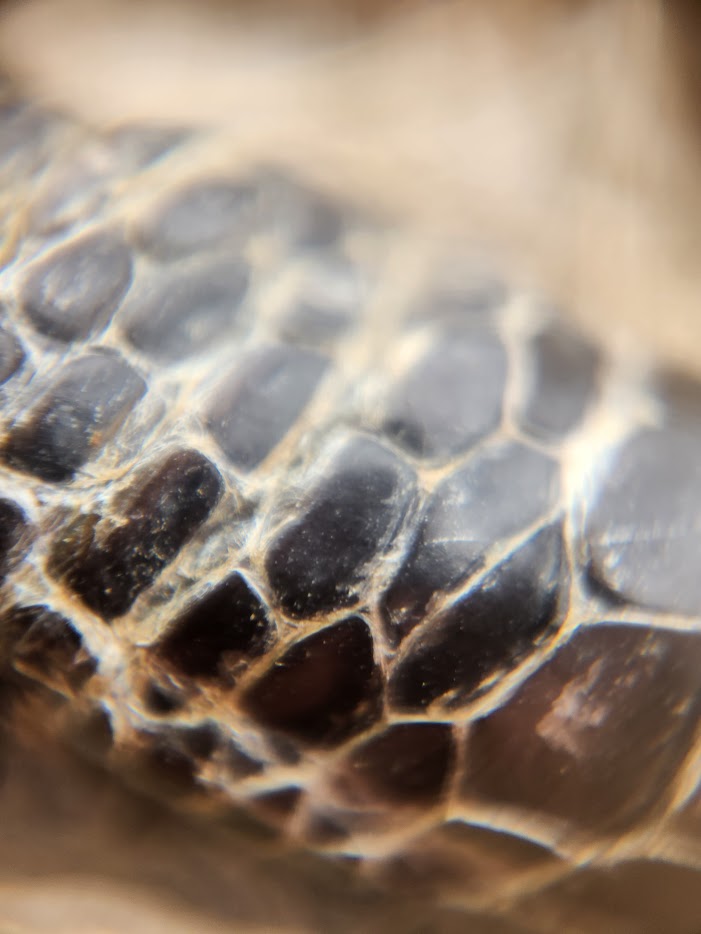

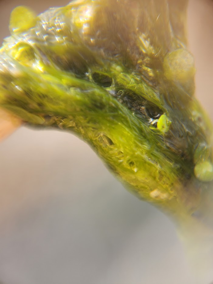

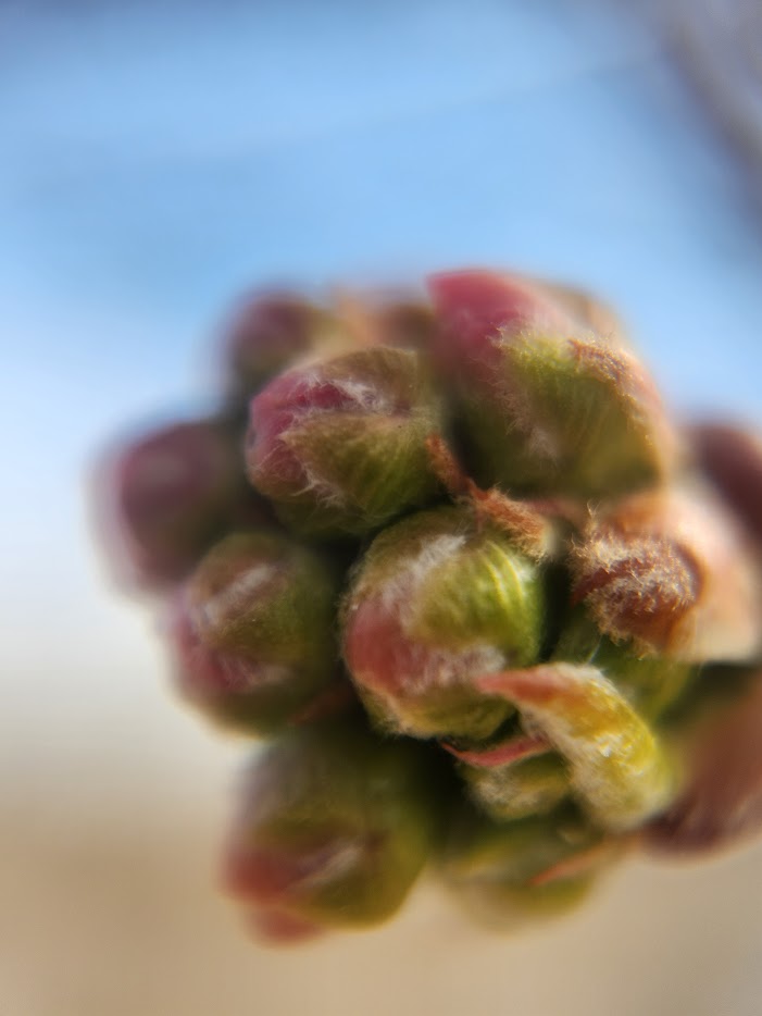

The results were super great! The ipad camera seemed to do well with lenses 10mm-14mm in diameter (larger diameter became a bit more like a macro lens, than a super high focus microscope)
one kid photoed a mosquito!

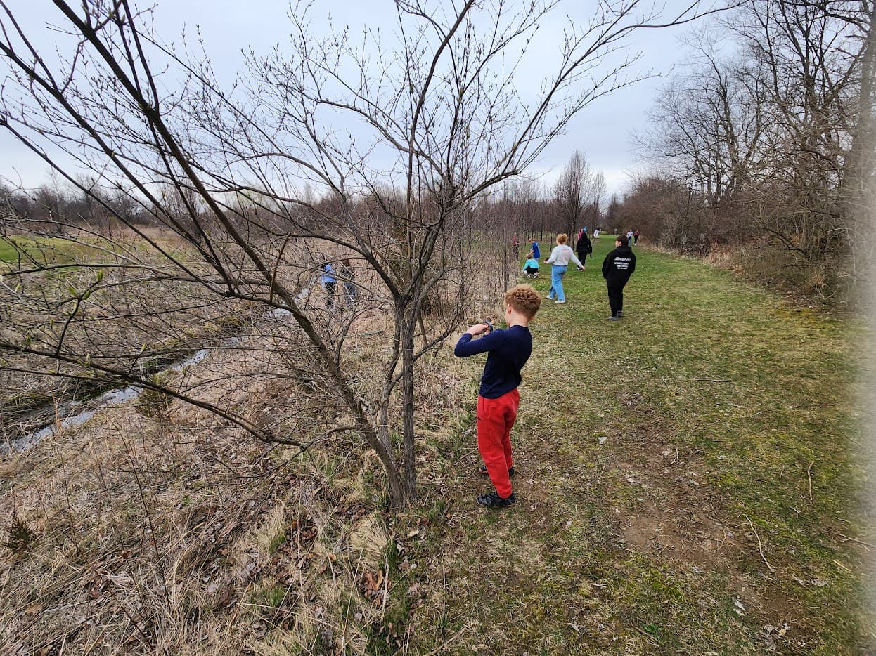

Update! It happened to be earth day and i was visiting UW campus, so i figured I would use some leftover lenses and do another impromptu workshop out on the quad.
We got about 15 people to build their own microscopes and explore the microcosmic lovely nature around them!
This time I went with @dusjagr 's excellent sticky tack technique and it worked great!

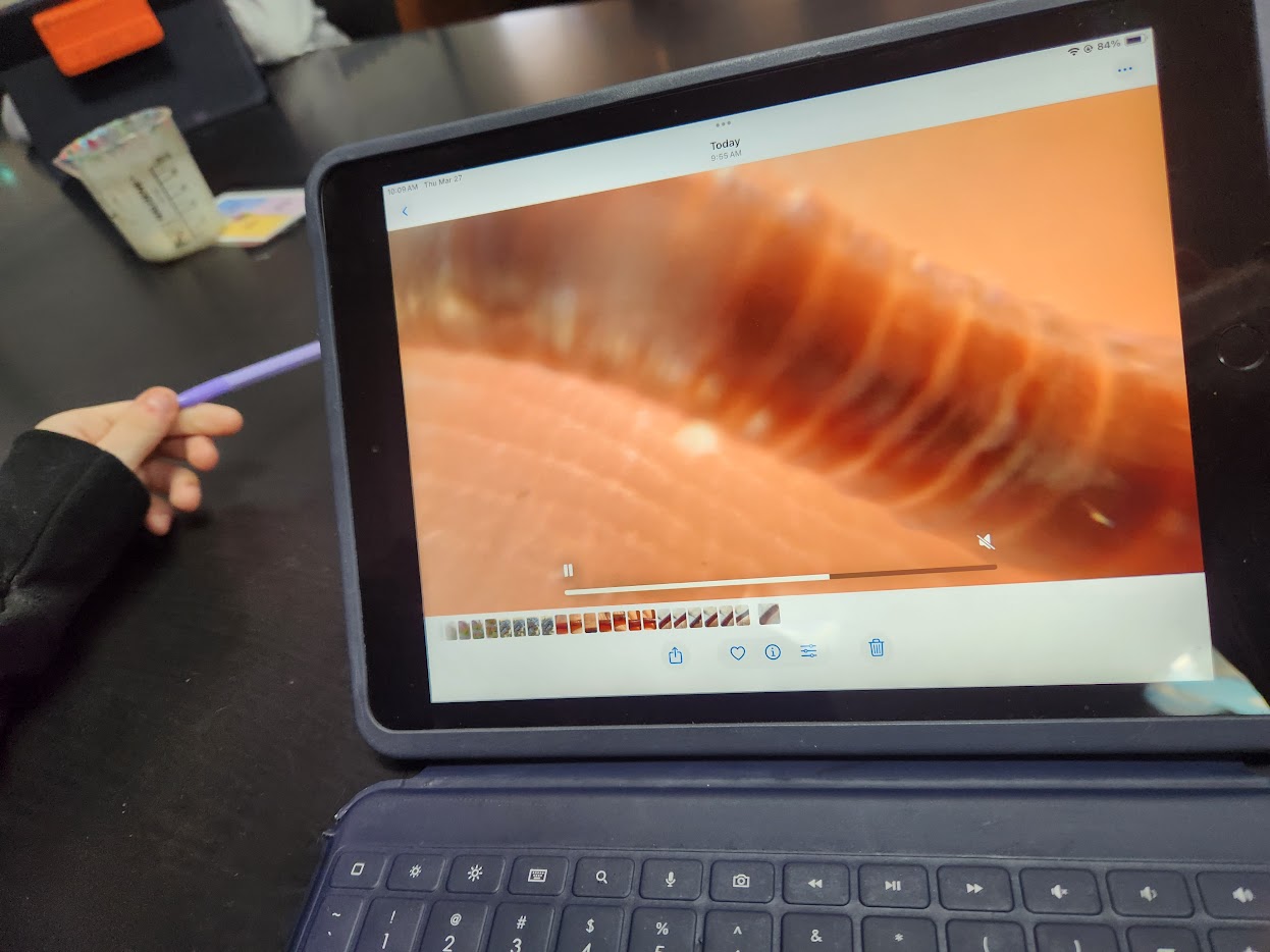

Worm was the coolest!
