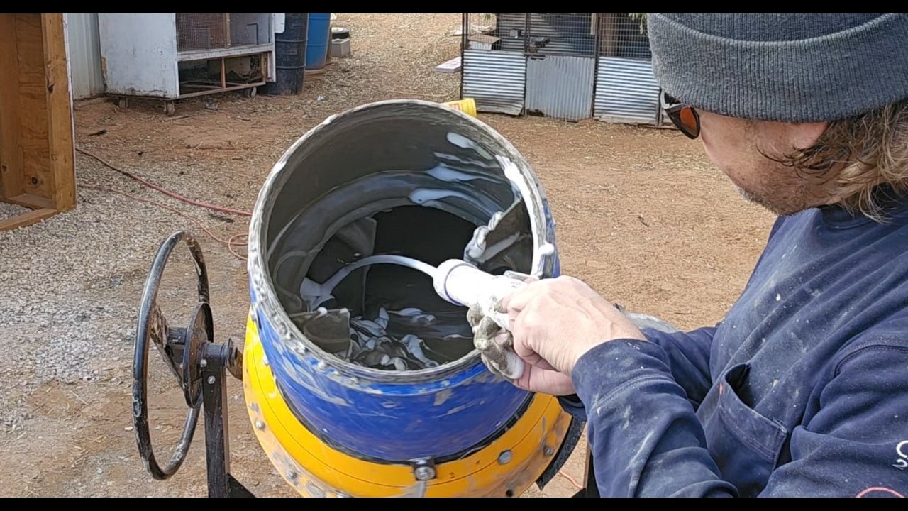

After 2.5 years of work, I’ve finally managed to design a DIY mixer that can be built using a regular “tumbler style” concrete mixer, $50 USD in scrap steel, and a 120L HDPE drum. It works really well.

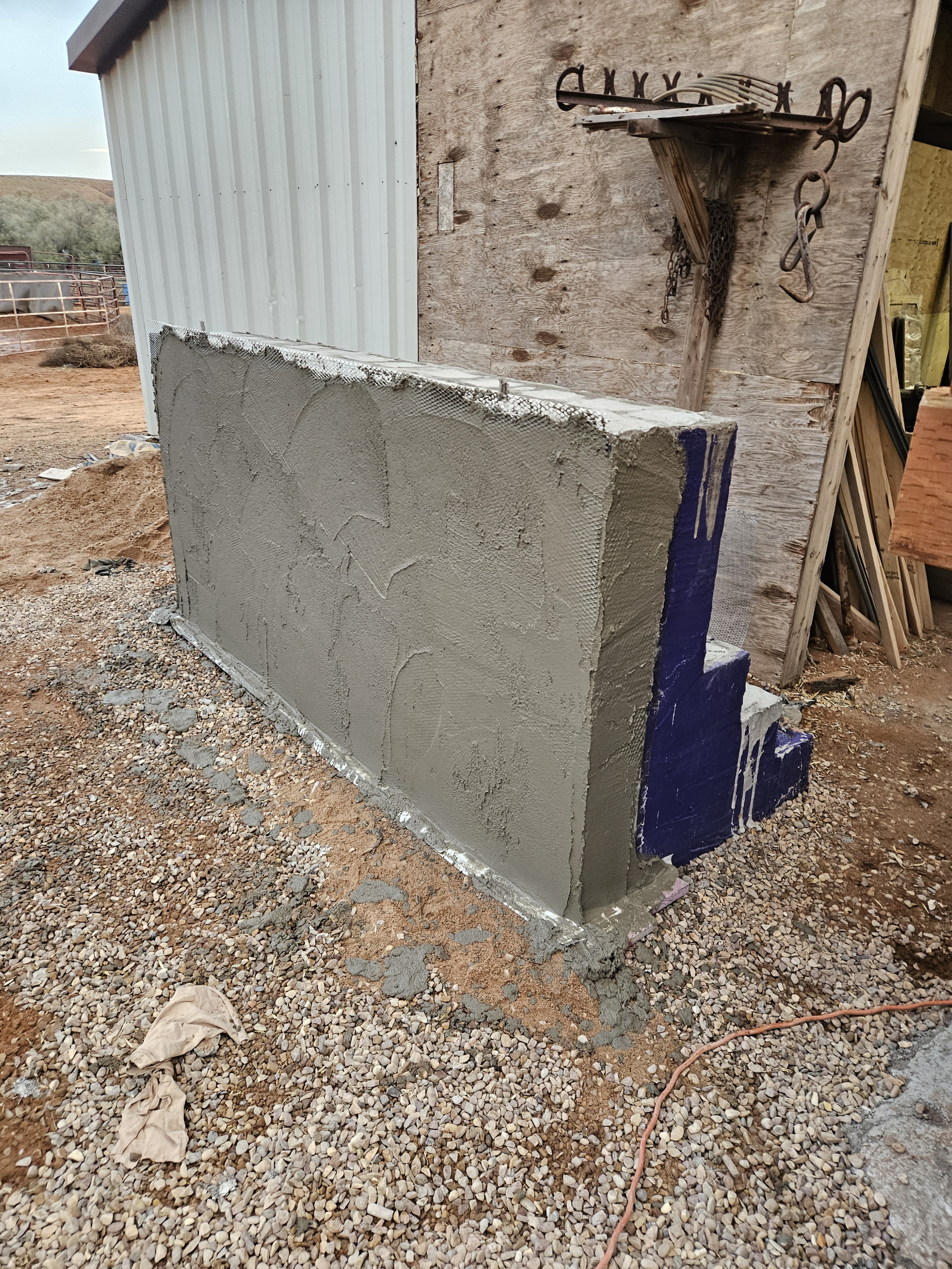

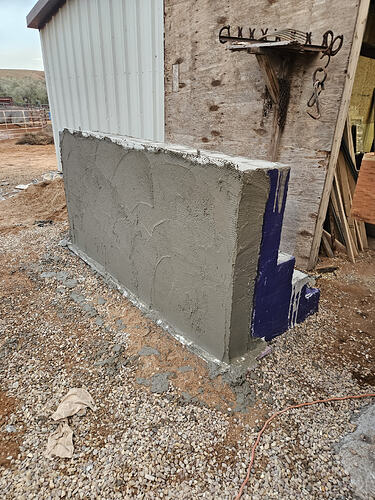

The test wall in the image below is an ordinary cinderblock wall with 15CM lightweight insulating concrete. It improves the thermal resistance approximately 20X.
I painted that prototype wall and have added some visual clues to what is going on. Apologies if this isn’t clear, I’m not a good photo editor. I guess I’ll have to hire one as it’s sometimes difficult to get my point across. I’ll answer questions if anyone has them.
Bulding science teaches us that most buildings would benefit from continuous exterior insulation, or a “thermal break”. In the global South, insulation materials like rigid foam board might be expensive, difficult to source, and aren’t ideal to attach directly to block walls. In this example of a concrete block wall, the exterior of the structure is represented by the red “X”, on the left. The interior by a blue “X”, on the right. And the foamed concrete insulation is indicated by green arrows. The purple painted concrete blocks have their hollow cores filled with foamed concrete and a 15CM width is placed directly adjacent to the purple block structure (on the left).
The thermal resistance (aka insulation) and thermal break is delivered by a combination of the 2 different locations of the foamed concrete. Again, building science teaches us that the higher thermal capacity material (aka thermal mass), belongs on the inside of the building envelope. And it is…that’s the purple blocks.
