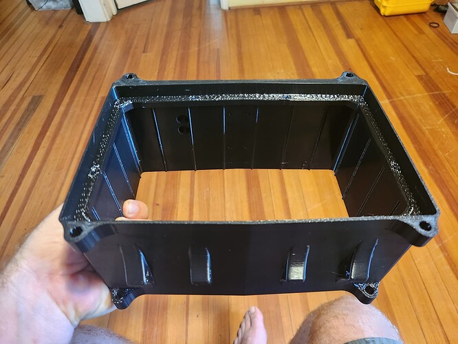

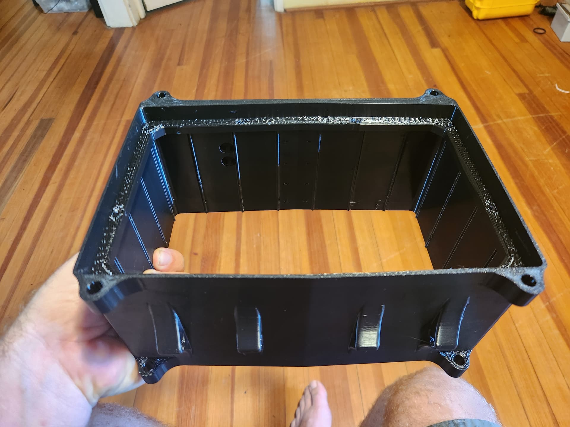

In the latest Mothbox box we are making there is a recessed lip that needs supports to print.

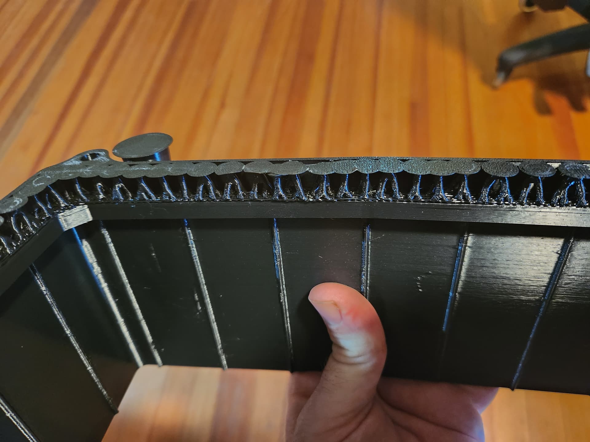

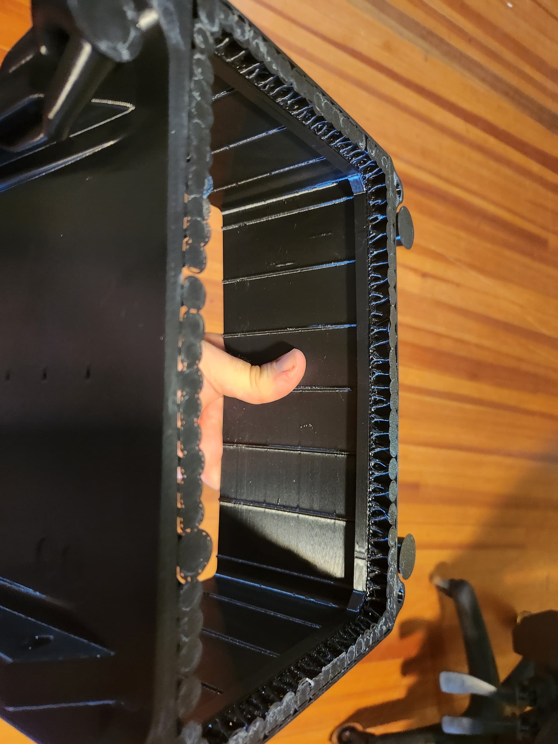

We use auto-generated organic supports right now, which frankly are pretty darn good!

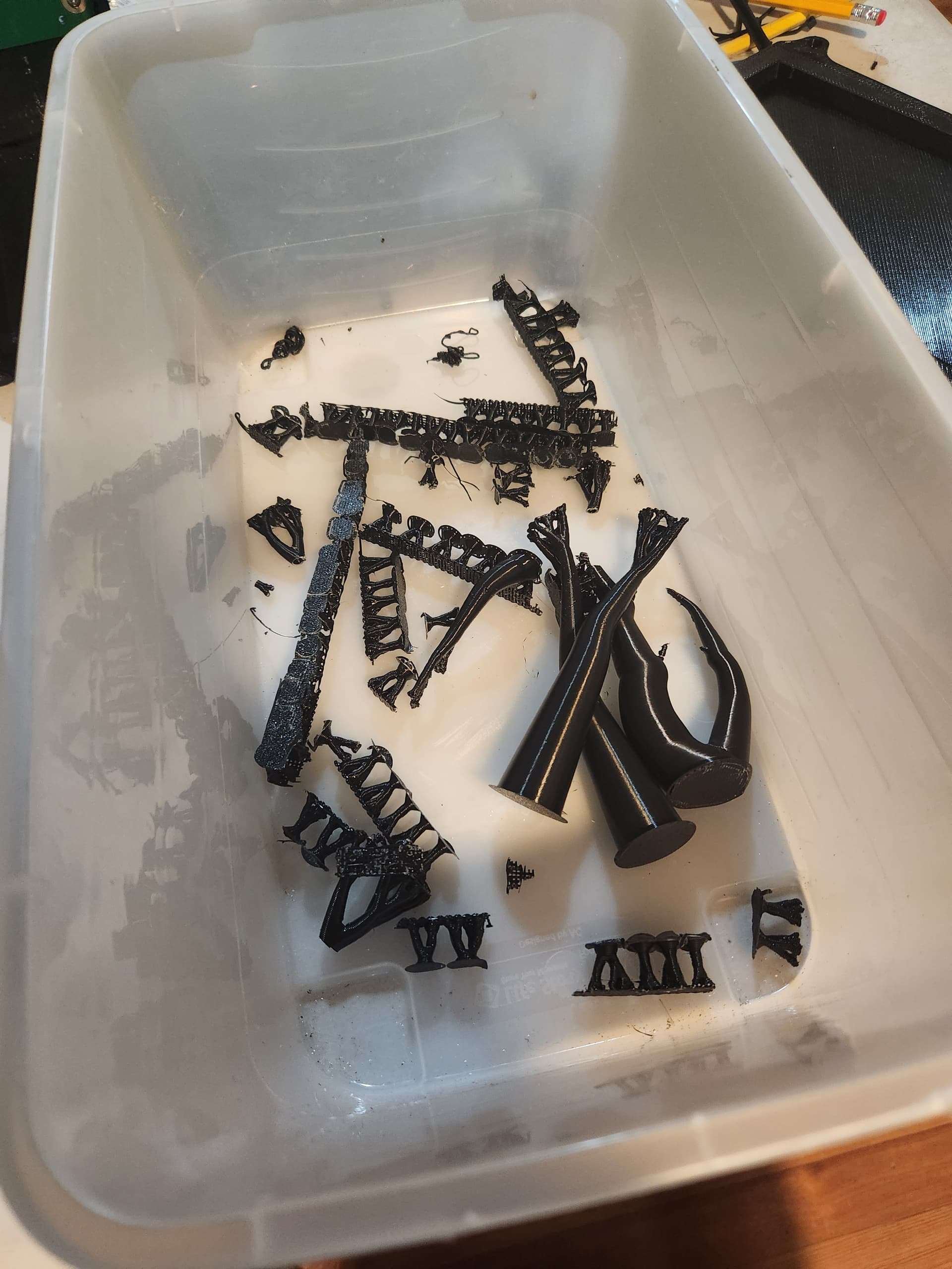

But it does end up requiring about 5-10 minutes of time to remove, and wastes a bit more filament than is probably necessary.
I could pretty easily design some kind of thing that goes up to that side of that lip that is hanging in space, but when i slice it, the slicers tend to just want to keep laying long parallel lines that are still unsupported.
Also if you have made custom break away supports before, what’s the design theory? Do you keep some kind of gap between the support and the print so they print really close but not completely fused?
We are doing .8mm nozzle with .4mm layer height
In abs or petg-cf
