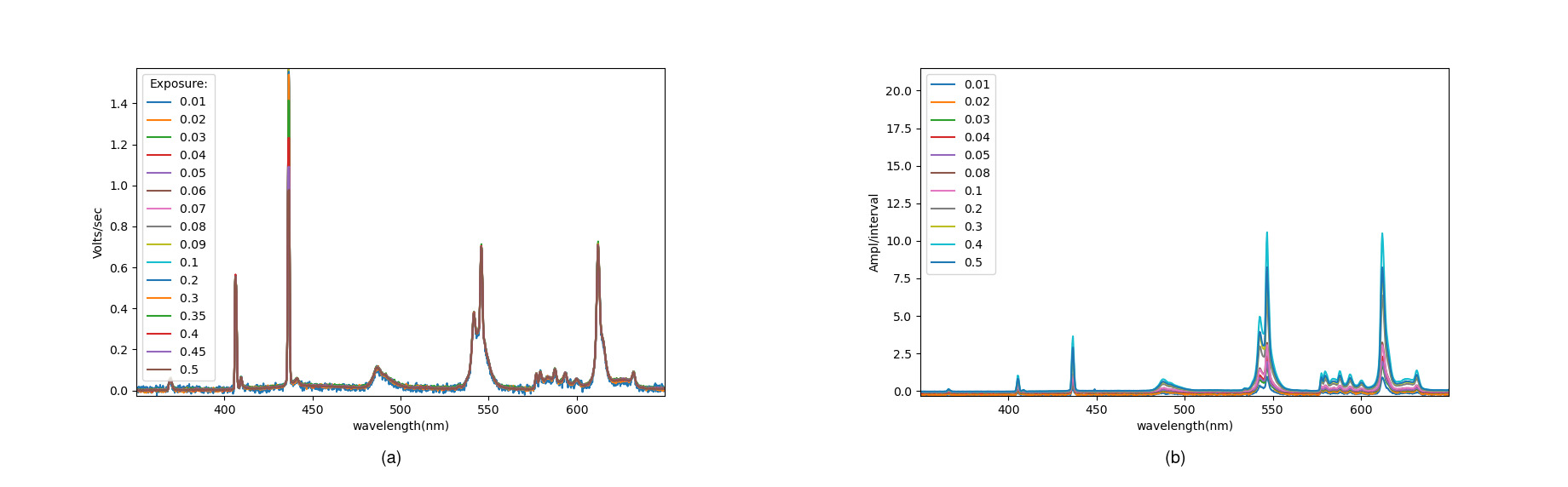

In this first set of graphs, the spectra at different exposure times are divided by exposure time. In a good instrument the spectra normalized in this way should overlay each other. That is what we see with our new sensor device. Also, in our instrument the line at 435nm is about twice as large as the line at 546 nm. Those are two lines of Hg that are present in household fluorescent lamps and their intensity ratio should indeed be about 2:1, as they appear in our instrument.
We might ask, why is the 435nm line so weak in the commercial instrument? Is it due to some optical problem? It is an expensive commercial instrument, but maybe it is not focused or aligned properly. Let’s look further.

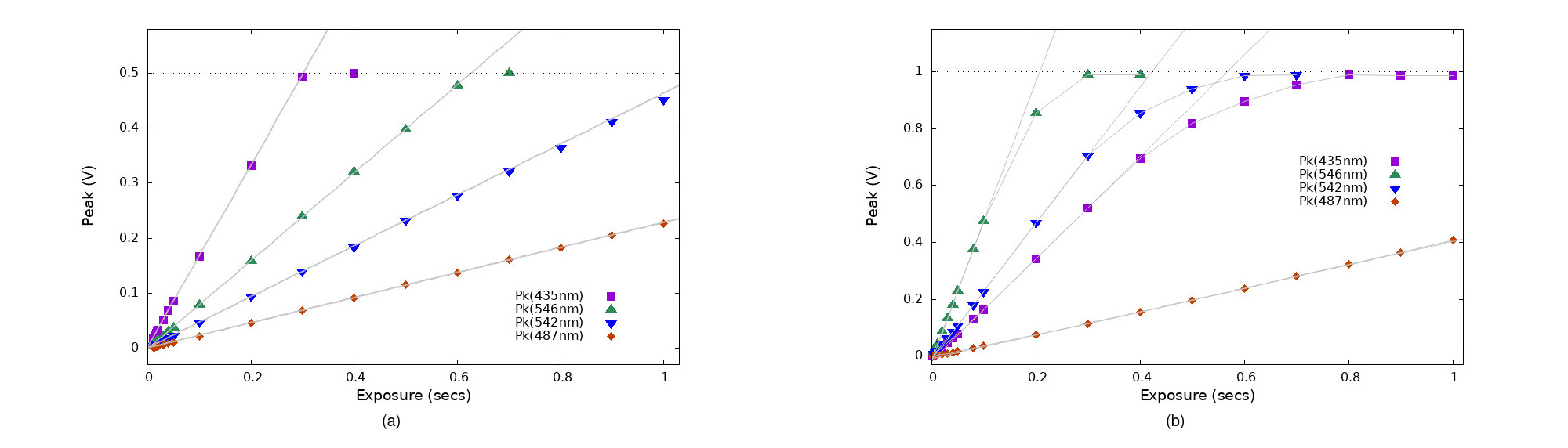

Here we graph the raw peak heights against exposure time. Again the graph on the left (a) is our new instrument. As you can see, we are pretty linear – for almost all of the sensor’s dynamic range the data produced by our instrument follows a straight line.
We can understand from this that when an instrument is not linear, spectra taken under different conditions will look different. That is because the curves on the right (b) don’t track each other. That is a very important point and one which should be concerning. as follows.

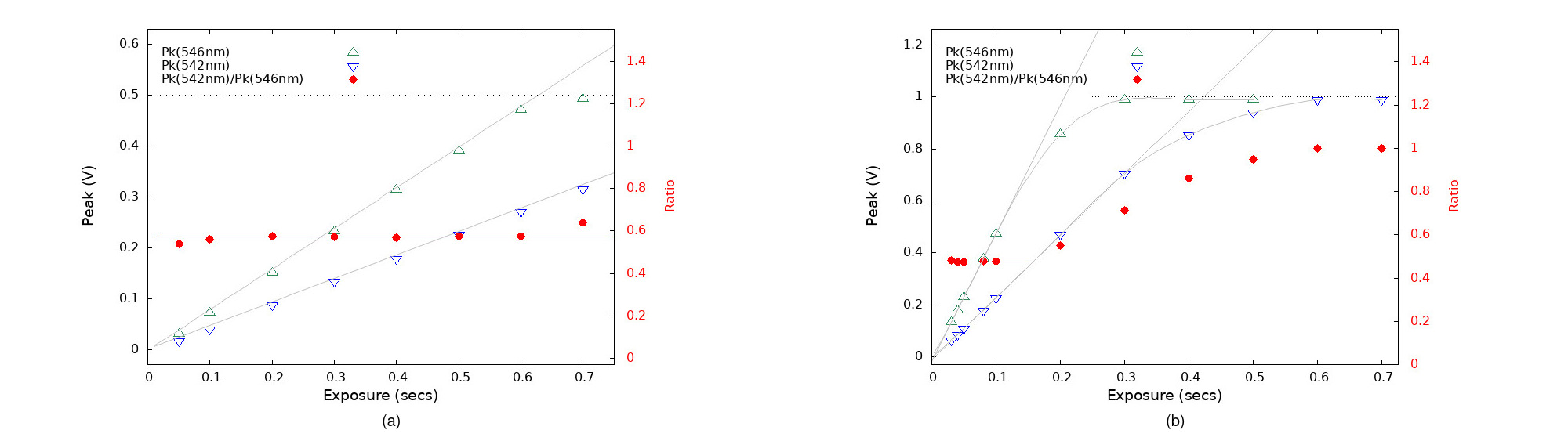

Here is a specific scenario to illustrate how linearity can be very important. The lines at 542nm and 546nm are due to Tb3+ and Hg, respectively. Suppose we want to write a paper on the relative presence of Tb and Hg in fluorescent lamp vapor. So, we collect a bunch of lamps and measure their spectra. Naturally the lamps will vary somewhat in overall intensity.
Here is the relative intensity of the Tb3+ and Hg lines versus exposure time (recall that exposure time is our stand in for intensity). Which instrument would you rather base your data on for your paper on the relative presence of Tb and Hg in fluorescent lamps?
That is the punch line, more or less. Data based on the instrument on the left (a) is more reliable and gives you a number that you might be able to use in your paper. You can easily invent other scenarios where this point is similarly important.
