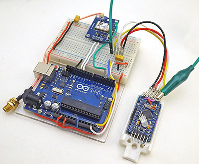

Finally got serious about synchronizing the RTCs for multi-unit deployments to improve data quality for things like tide signal analysis. Clocks are sync’d the leading edge of a GPS time-pulse and the Aging register is tuned to reduce drift. The quid pro quo is that the reduced drift within the tuning temperature range increases non-linearity at more extreme temperatures. But our underwater/cave research sites are quite thermally stable compared to outdoor climate stations, so it’s worth that tradeoff. Setting Accurate RTC time with a GPS & the DS3231 Aging Offset to Reduce Drift | Underwater Arduino Data Loggers

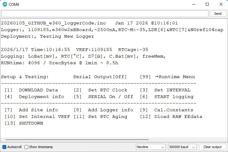

Just a note to let GOSH know that there have been several substantial updates to the serial interface to the logger base code over the last year. Most to enable smoother progress through lab activities when the EDU logger is used in courses. EDU model Github
You still have to uncomment defines to enable various sensors at startup but most of the other typical configuration steps are now menu driven:

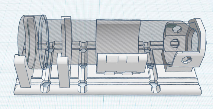

Just posted a 3D printable file for a universal mounting bracket that accommodates both 30ml (self standing Caplug) and 50ml (Thermo NUNC) centrifuge tubes. This gets used primarily for out-door sensor mounting and the NTC calibration lab water baths. To hold the larger 50mL e360 student loggers down in the water baths attach six M10x30mmOD 2mm thick stainless steel washers to the flat underside face of the bracket with zip ties:
You can download the stl file from the e360 GitHub repo at:
https://github.com/EKMallon/e360-Classroom-Data-Logger-2023
as I still haven’t gotten around to sorting out a Thingyverse folder for the project.

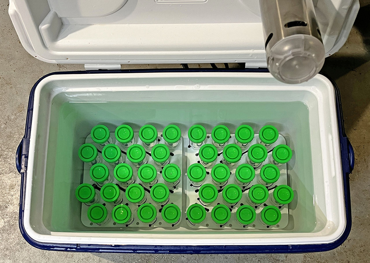

Combining a Sous-Vide cooker with a cooler gets you a temperature control rig perfect for calibrating / normalizing a large batch of temperature sensors. And this kind of DIY setup has enough volume to handle a mixed batch of sensors from different vendors - although you will have to give them several hours at each temperature plateau if they have a lot of thermal mass. Sensors that are not water proof can be wrapped with food vacuum sealers that sous-vide chefs use for cooking.
https://thecavepearlproject.org/2026/05/12/normalizing-a-group-of-temperature-sensors-with-a-sous-vide-cooker/
